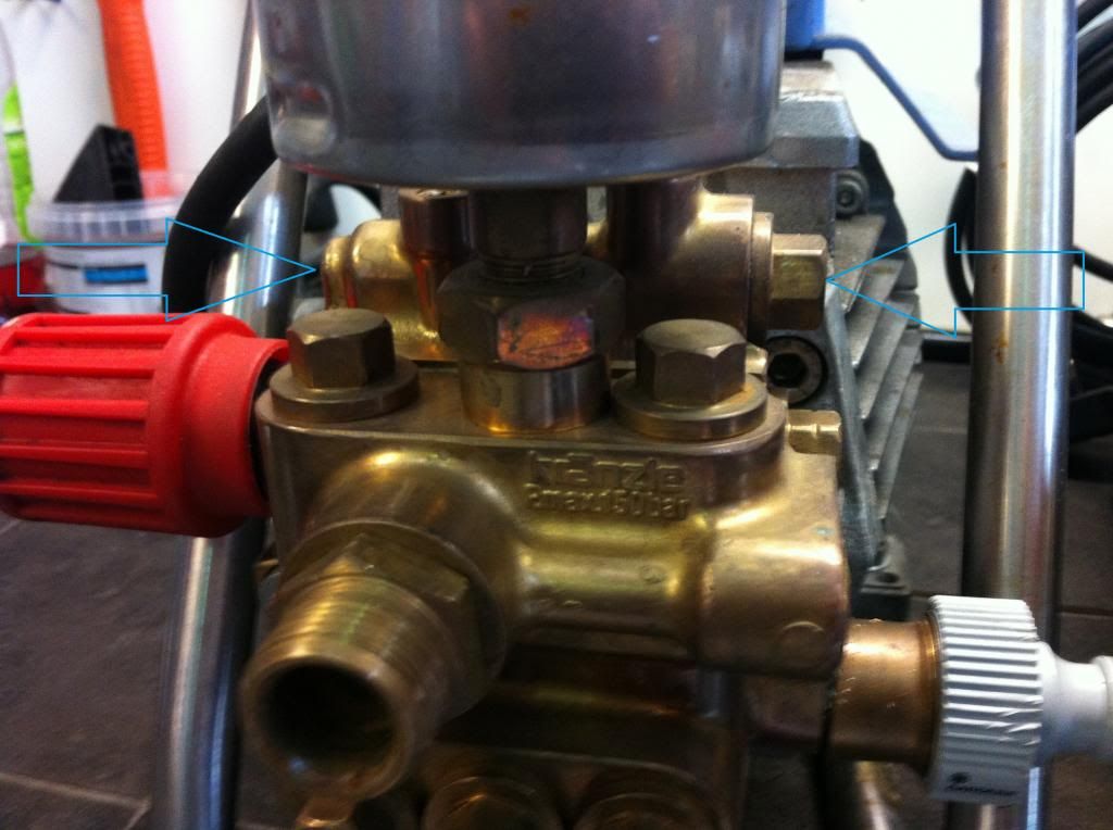

Most 7/120 or 10/120 machines out there can be converted to a total stop system, only the very first ones cant and now also the 122 models. To be sure yours can, have a look at your brass pump head (or take a picture for me to see) the attached image below shows the section of pump head that houses the pressure switch.
This next image shows one that can not be converted without replacing the pump head completely.
Providing your pump looks like the first shown then conversion is possible.

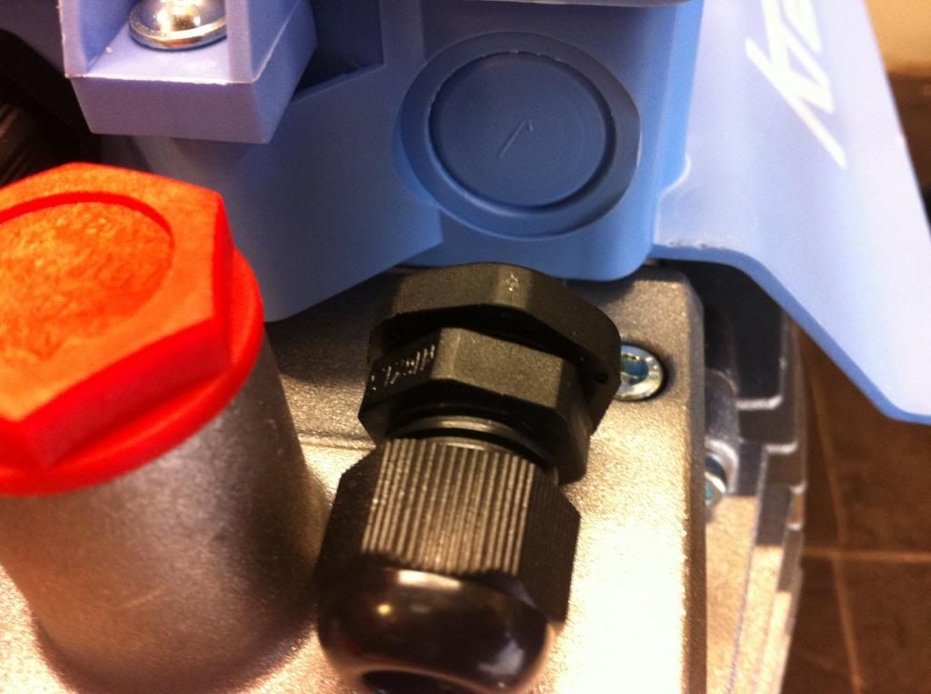

This image shows the blanking plug that would be removed and the pressure switch that would replace it.
And finally the new pressure switch would just be wired into the electric circuit.
