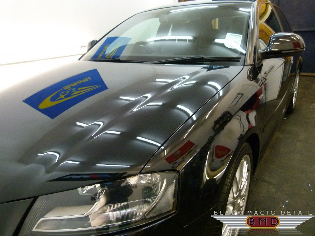

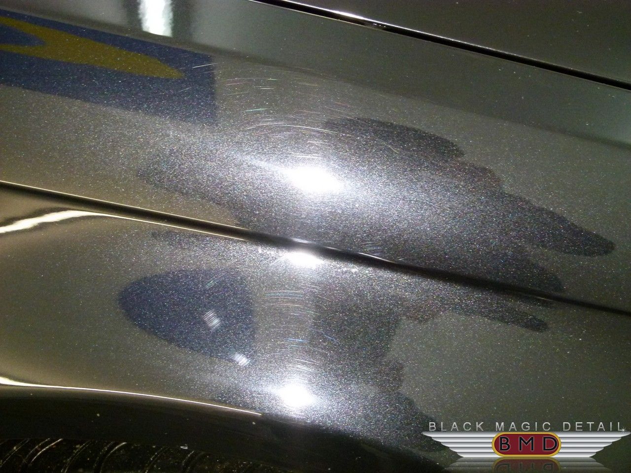

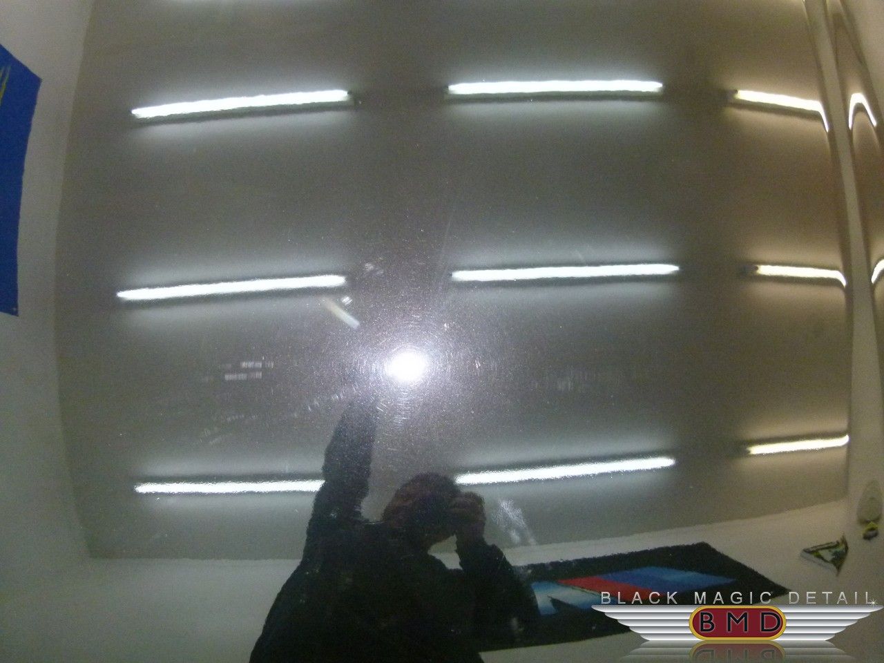

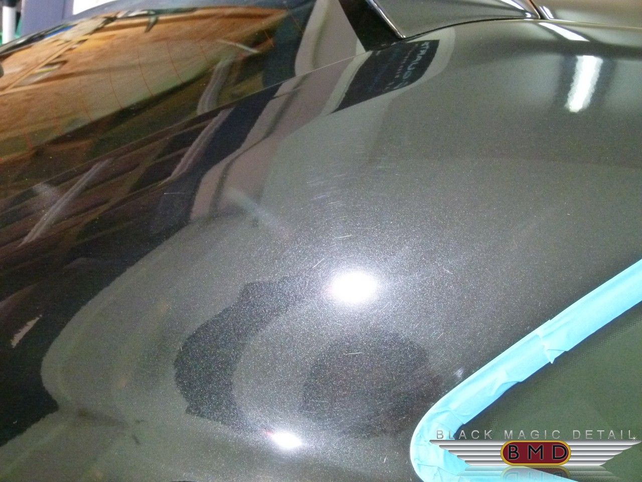

Hi All, we had an Audi A3 S line in for a single stage enhancement detail ,just a short write up for you all .
Full wash and decontamination was carried out before a single stage of polishing with Maxolen PM1 polish and a 3m yellow pad ,glass cleaned and sealed ,tail pipes polished ,arches ,tyres and plastics dressed,wheels sealed with BMD Revolutions wheel wax.

How long did machining take plus was the paint refined a tad too amp the gloss levels.
Just machine time was around 10 hours with my trusty now old school Makita,no separate stage of refining just finish each set of Maxolen off with a few slow speed passes to refine ,all done in 1 stage of polishing and 1 coat of Helios wax to achieve this finish.
