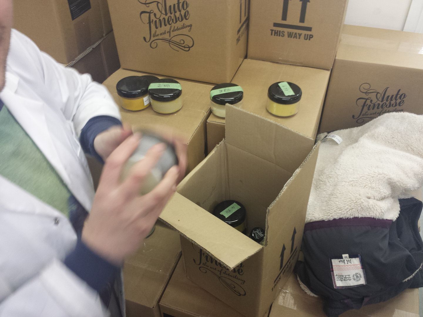

James suggested we could use one of his better prototype recipes - known simply by number. He showed me a pour of the wax, and it was a superb texture - it just needed colour and scent! He had a MASSIVE selection of prototypes!
