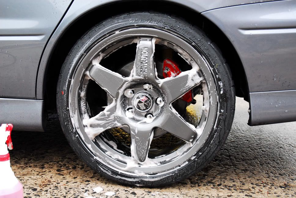

Onto the Wheels then. As always, the wheels are done first. Thankfully Andy has only recently put these wheels on the car so are a dream to clean. They were cleaned using:
AS SmartWheels Acid Free Wheel Cleaner (4:1)
EZ Detail Daytona Wheel Brush
Zymol 100% Horse Hair Wheel Brush
EZ Detail Mini Brush
Wolfgang Finger Pocket
The EZ Detail Mini Brush is fantastic for getting to especially tight areas, like the even smaller gap between Andys new XYZ Big Brake Kit!
These Wolfgang Finger Pockets are great for getting the back of spokes clean and getting anywhere you cant physically see to clean as you've a great feel unlike with using a brush.

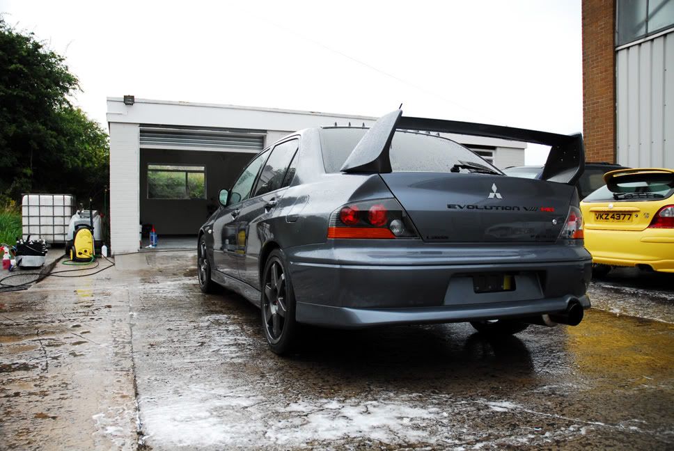

The Car was then rinsed again and then ready for the Wash Stage to Begin.
You can see here the water lying extremely flat to the paintwork indicating no Protection or LSP.

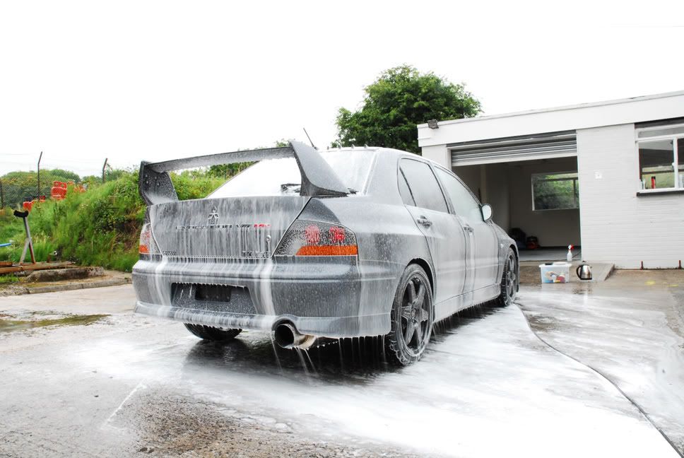

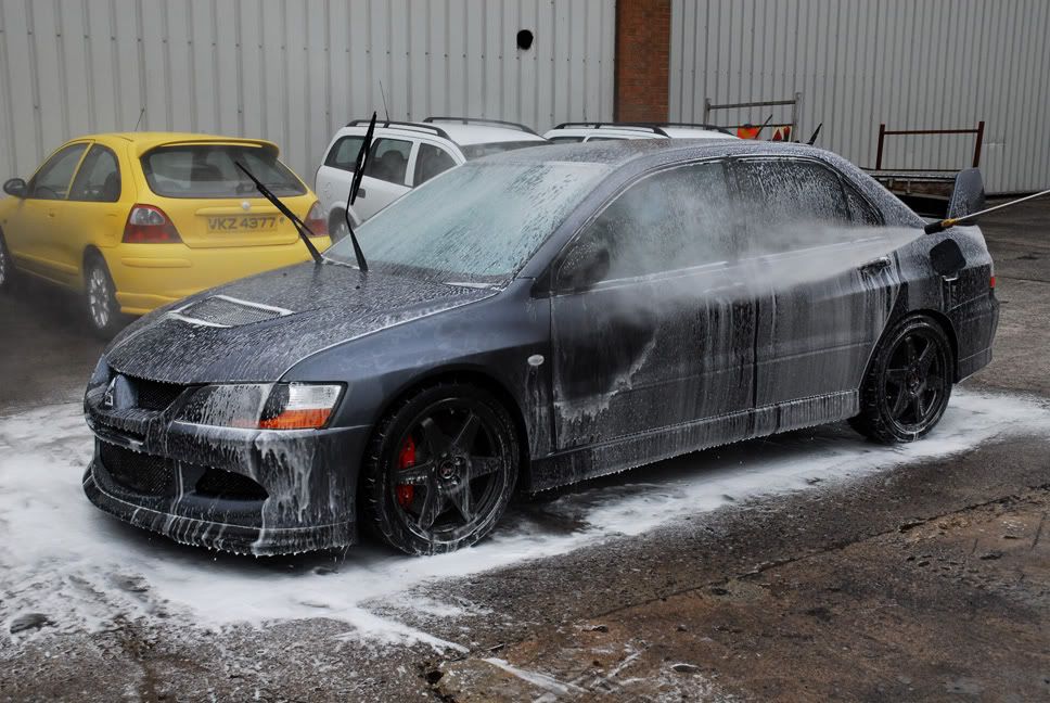

I then switched to the HD Foam Lance for the Pre-Wash.
The Car was then Foamed with Megs Hyperwash using the Foam Lance and then Left to Dwell for 5 minutes. And then thoroughly rinsed off
The Car was then Re-Foamed, and washed by the 2 Bucket Method with Megs Shampoo Plus using 0ppm Filtered Water from a Resin Filter, Zymol Wash Caddies and Zymol Sponges.

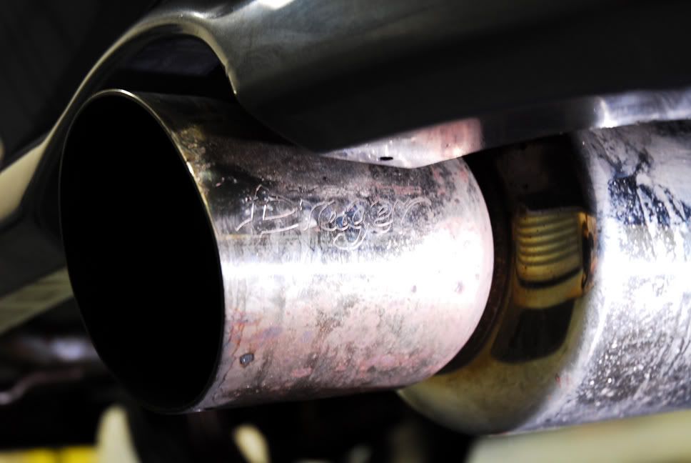

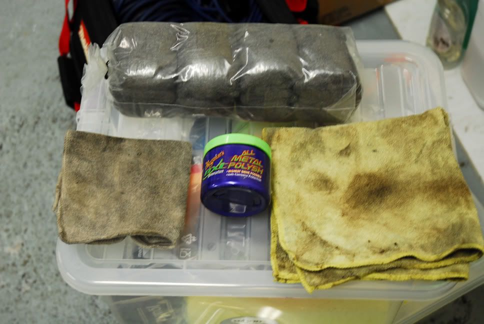

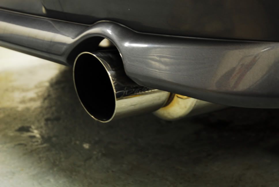

But look at that Exhaust, brings back memories of the last Evo I done not fun either! :(
On a Lighter note, while I was down there I briefly distracted myself.. I love really clean wheels and getting right into the backs makes all the difference IMO :)
But I was not looking forward to that Exhaust later on..
The Sticky Pads and Bonder were then both were removed with AS Tardis. But have a look at the state of the MF after removing the Bonder

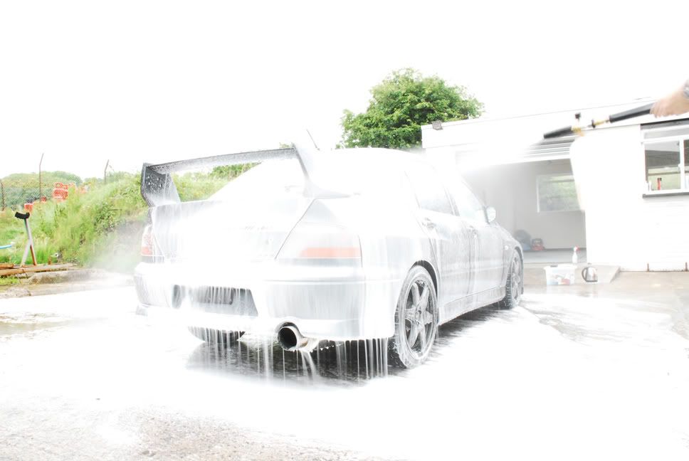

So finally, the Car was Foamed and Rinsed with 0ppm Filtered Water thoroughly one last time for the day to remove any particles that could damage the paintwork when Polishing.

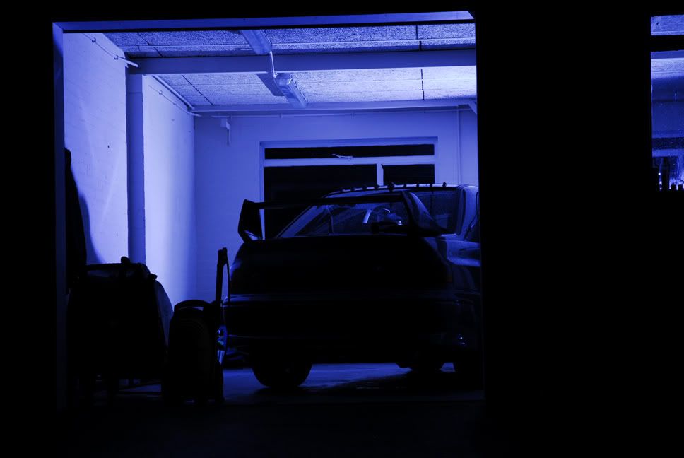

And Car locked up safe and sound for the night.
Or so I thought..

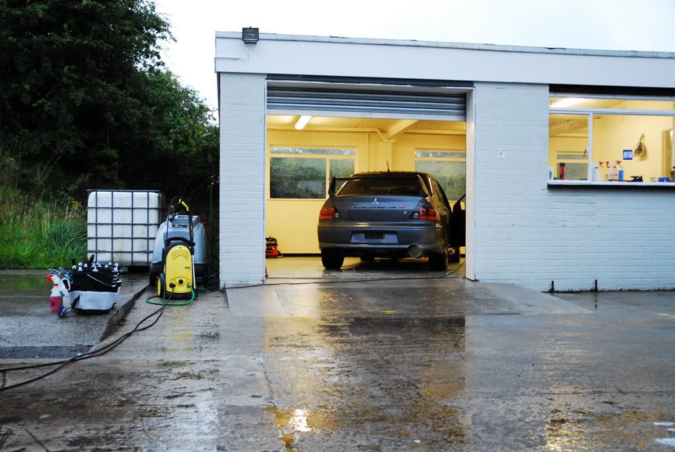

Couldnt sit down after dinner, so back down to the Unit and cracked on with the Interior.

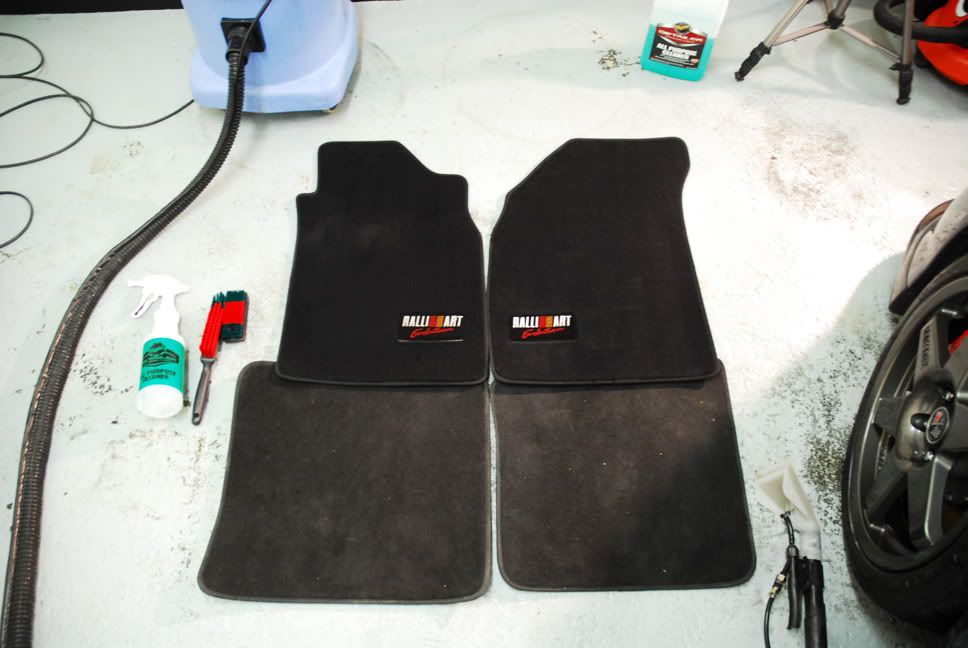

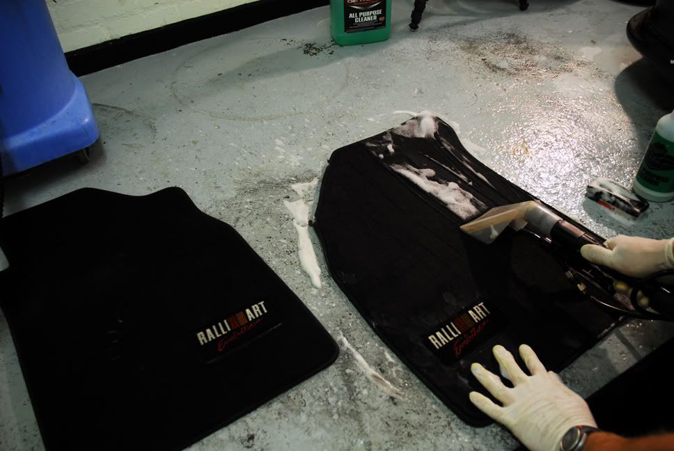

I first of all I started with the Mats.
Which came up very well, and turned out like this
Before on the Right, After on the Left.

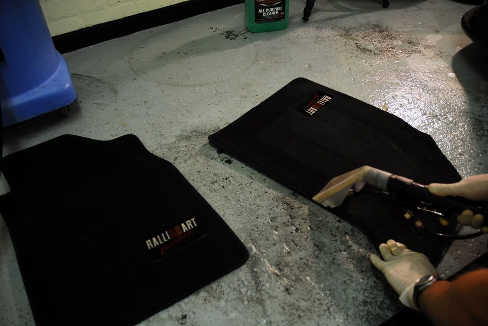

And this is the process. Firstly, give a thorough Brush with various Vikan Interior Brushes to loosen any engrained dirt.
Then Sprayed with Megs APC (10:1)
Gently massage the APC into the Embroided Logo so not to damage it.
Then by Brushing the Outer Edges and Piping.
And then giving the rest a good firm brush to agitate the APC into any soiled areas.
Quickly Extracting the Mat
Then Lightly Brushing the Embroidery with a soft long bristle Vikan Brush
And Finally giving the Mats a thorough Spray with Megs APC via the Wetvac and Extracting
Leaving the previously soiled Mats like this

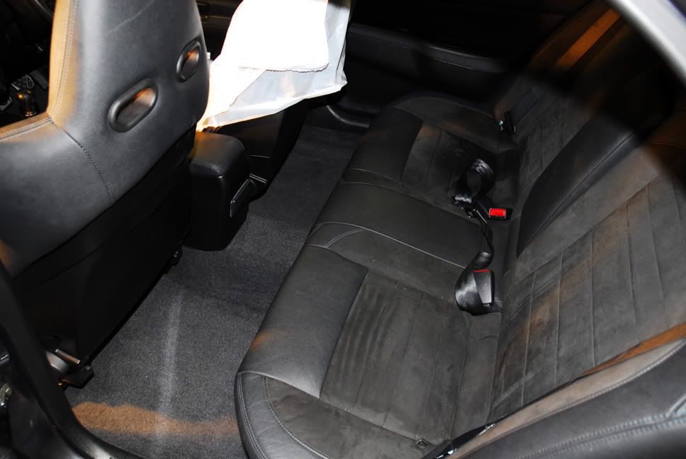

On to the rest of the Interior..
Generally pretty clean, and nothing Henry couldnt sort out :)

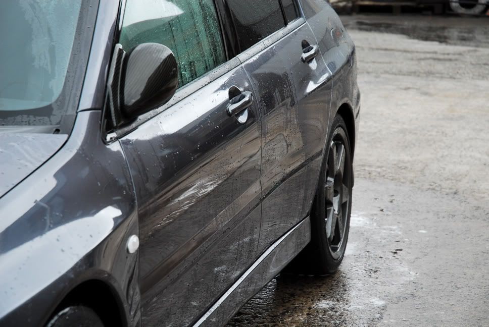

As you can see, even in natural light some of the defects standing right out. Some how from this moment, I knew this wasn't going to be as enjoyable as I had hoped.
So out with the Sungun then..
I actually struggled to pick up the true level of defects with the Sungun. If held too close to the paintwork it seemed to just light up the flake in metallic or not show the true level from a distance.
Although it was clear from the defects I could see in Natural light the what condition the paint was in, I really couldn't seem to capture it with the Sungun.
So out with the Halogens, but these didnt prove all that much better either
Although these were better, they still didn't seem to show them very well either except for very certain angles. So with the Halogens and my 3M Sungun rendered useless!
I really couldn't seem to capture the true nature of this beast.

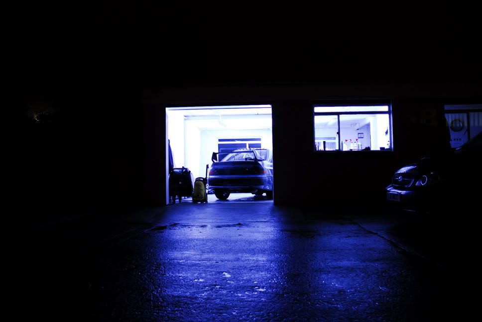

But before leaving I removed the remaining tape and quickly tidied up and took a few night time snaps :)

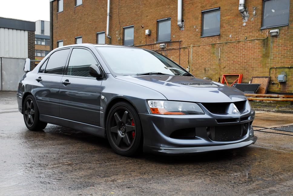

The Car was then brought in and Dried, before being given a coat of the Andy's own Wax (Raceglaze 55) so that he could continue to easily top up the LSP himself.
Here are some quick shots I managed to grab furth down the Industrial Estate before Andy had to shoot off :)
Nearly forgot you're Number Plates Andy! Back up to the Unit and very some final snaps and one very happy Owner :thumb:

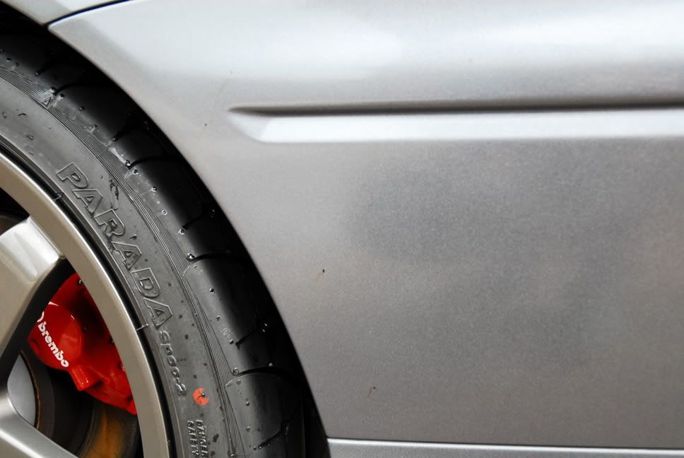

One thing though, is it just me and the funny light, or, is the n/s front wing a different colour to the rest?

Re: The wing. It is the same colour. It must just be the angle of the light. The Doors are the same colour because they are all at the same angle, and the wing is the same colour as the front end of the car because it's more in the shade. I certainly didnt seen difference in the metal. The only variation I seen was between some of the plastics and thats just the normal difference between metal and plastic panels.
