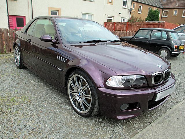

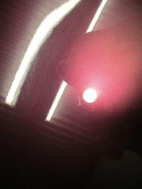

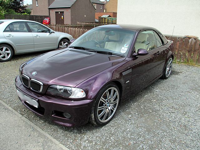

This customer came to me requesting a correction detail and also he wanted the engine bay done too. It was obvious to me that someone had attempted to machine polish the car before and had not done a very good job - pig tails, circular scratches, holograms, etc. were all present.
The owner told me that only 21 cars were ever made in this colour from the factory worldwide, which makes it pretty rare.

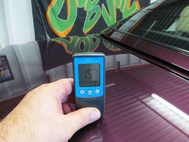

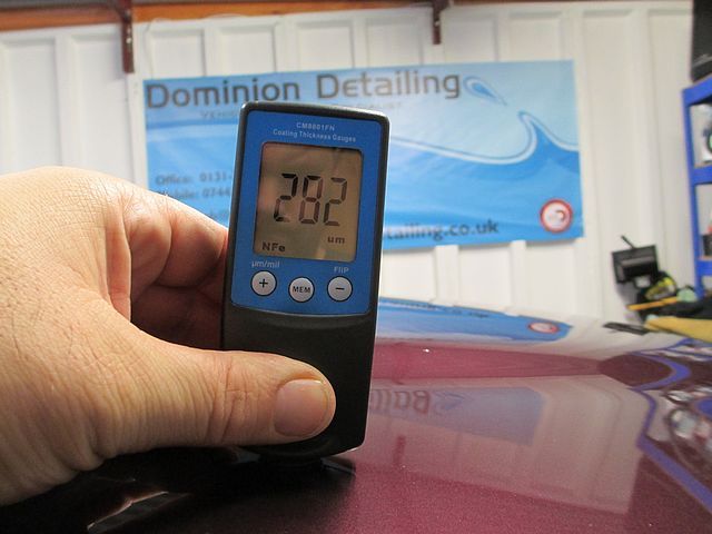

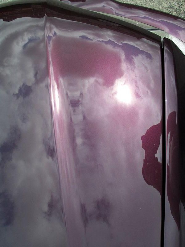

The bonnet had previously been resprayed at some point:

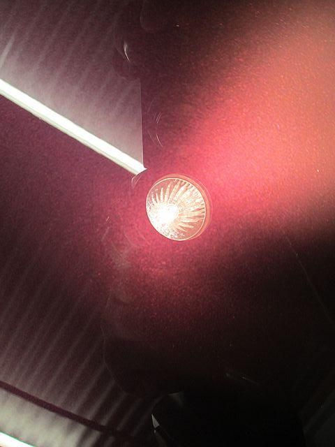

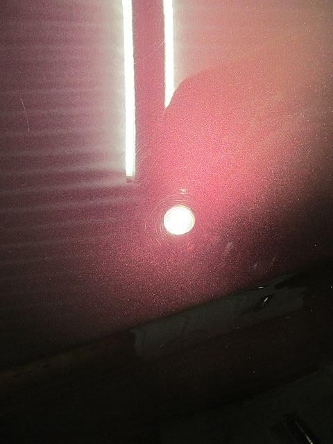

Paint defects:

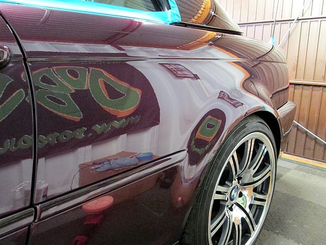

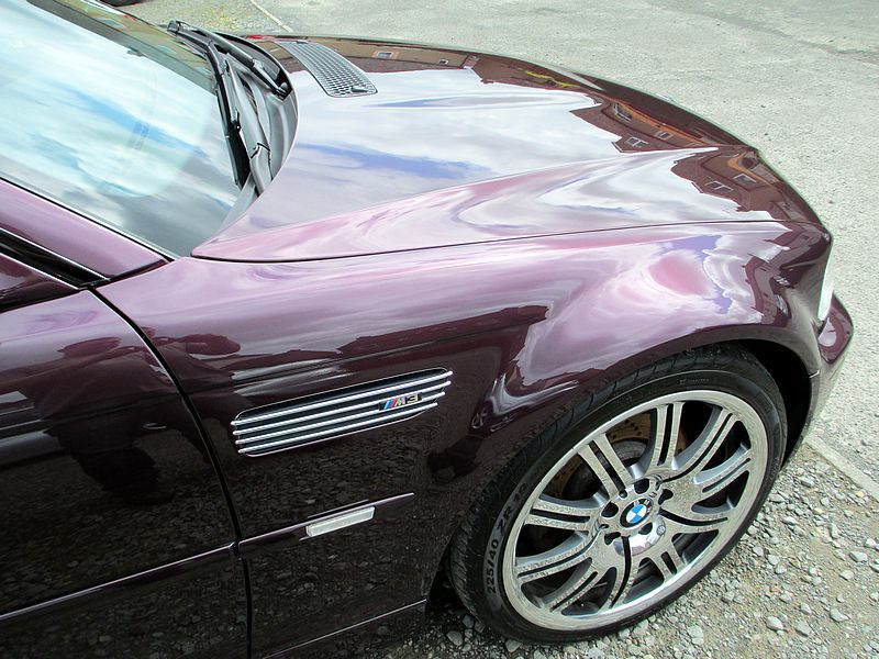

Correction was performed via rotary with Menzerna FG400 and a Lake Country CCS yellow cutting pad, some areas with Intensive Polish on an orange light cutting pad, refined with Britemax Black Max ultra-fine polishing glaze and sealed with Britemax Vantage wax.

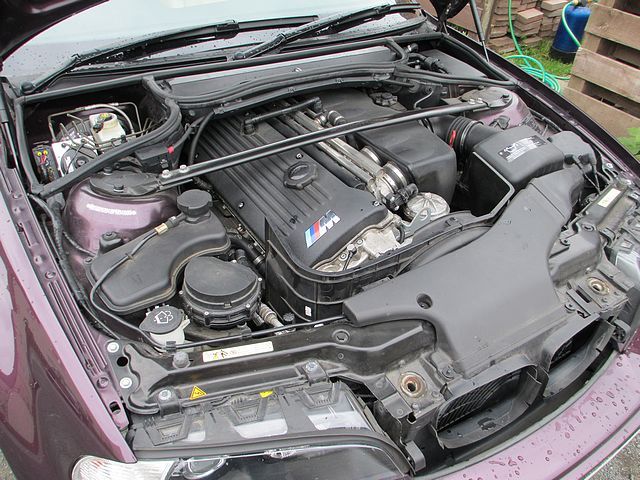

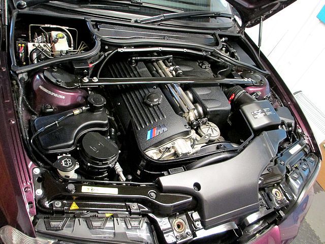

engine bay was cleaned with APC and hot water via hand-held pump sprayer and a brush (I never use pressure washers on engine bays) then rinsed off with hot water via hand-held pump sprayer. Once dry, the engine bay is dressed with Aerospace 303 protectant:

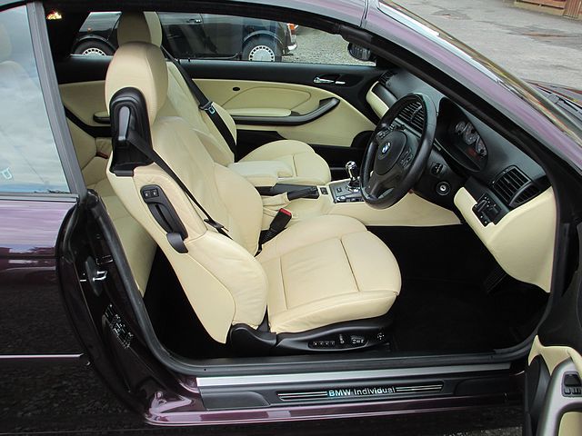

The interior was cleaned, hoovered and the leather conditioned with Britemax Leather Max:

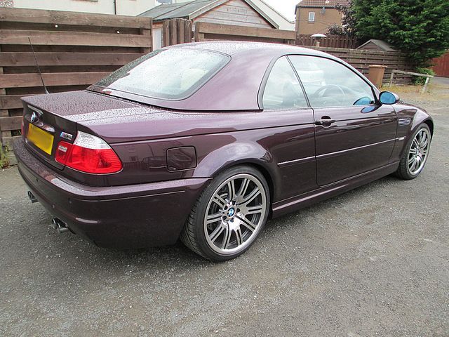

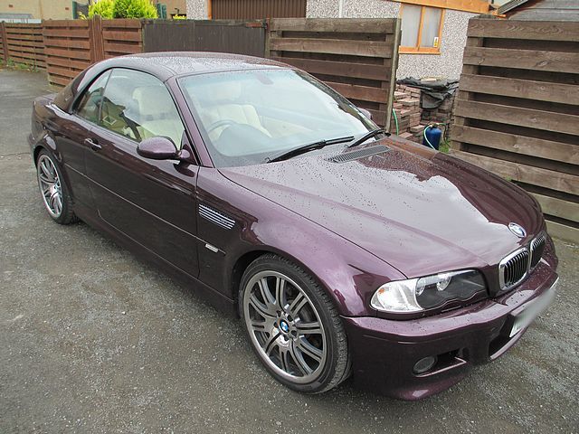

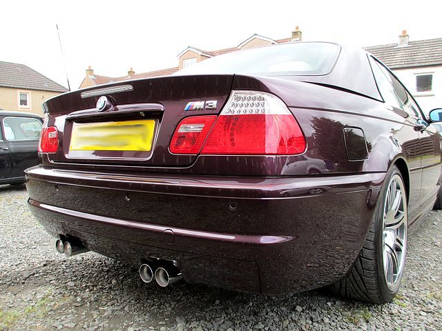

Wheels were sealed with Raceglaze nano sealant and tyres dressed with GTechniq T1. The end results were thus:
Customer was delighted with the results. Thanks for looking.
