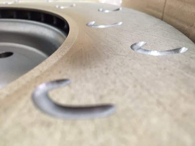

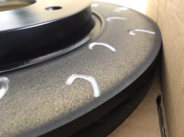

I decided to remove the grooved brake disc and replace with OE Suzuki again. I just couldn't put up with the "ticking" I was getting with them. Though I was warned before hand I didn't think it would grate on me so much.
Whilst there I gave the calipers a coat of silver Hammerite to replace the faded and rusty original factory finish silver.
The removed discs, covered little over 700miles.
Discussion starter · #45 ·
I did a bit of research, all be it after fitting and it appears that a few complaints have been made about grooved discs in general, not just this shape.
The ticking was constant, most prominent after 20mph and again faster ticking when braking. I suppose if you have a louder car/track toy it wouldn’t matter so much. But as you can see I don’t drive the car hard with the mileage photo showing 48mpg avg.
The ticking was constant, most prominent after 20mph and again faster ticking when braking. I suppose if you have a louder car/track toy it wouldn't matter so much. But as you can see I don't drive the car hard with the mileage photo showing 48mpg avg.
I wonder if you might have slightly sticky calipers - the pads are still slightly resting on the surface of the discs causing the ticking noise?
Calipers seem ok. There was very even wear when replacing the original set with these. The rears have a tendency to drag on this model which I have already addressed but not documented I'm afraid.

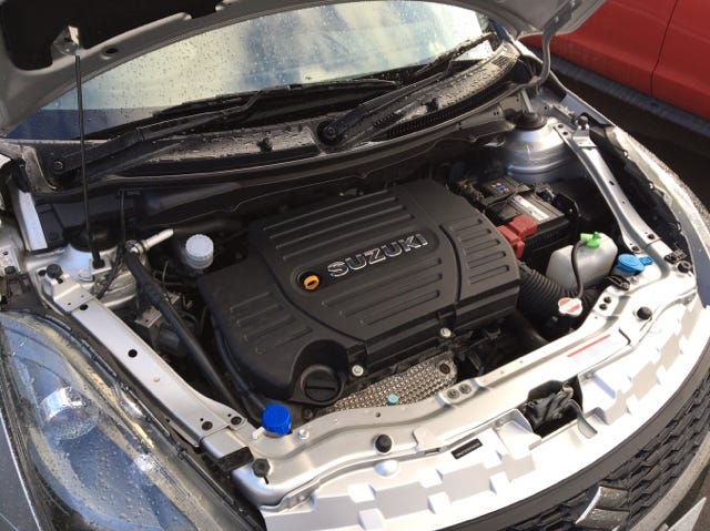

Something this morning told me to take the air box off and just check it. Here's what I found.
How? I'm not sure. It was wedged in so a removal of the cover was needed.
Another job off the list.

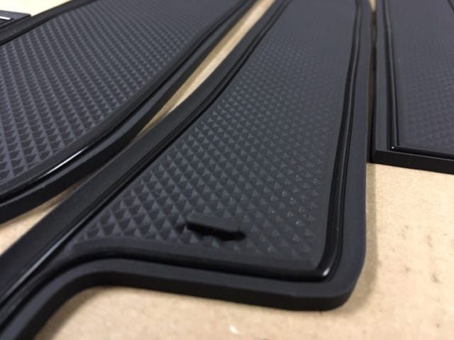

Love the passion and OEM look, hunting for the rubber interior mat protection what was the name printed on it ?
I can't find my exact ones. But these are close.
£11.32 11% Off | smabee Gate slot pad For SUZUKI swift SPORT swift 1.2 Interior Door Pad/Cup Non-slip mats red blue white 16pcs

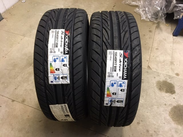

Gave the car a bit of love today, Winter oil change with OE filter and sump gasket carried out along with a set of Yokohama S-Drives for the rear. After being impressed with them on the front, I've ditched the GY F1's in favour for these. All tyres are now matching which looks a lot nicer too.

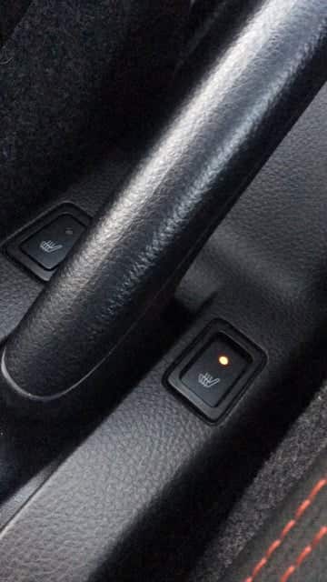

I was also having an issue with my heated seat install. The seats would not power until the car was warm. I checked all connections and everything was as it should be. I went back to basics and checked the battery which showed 58% health. Right before the cold weather is due to kick in, I took no chances and changed it for a new one, OE Suzuki VARTA battery. Bit annoying really as the old battery was OE and only 2 years old but there we go.

How did you find the tyres on the front? Looking for a new set of fronts for the wifes swift sport and saw the s drives. She doesn't drive it hard and still has the continental sport 3s on hers.
