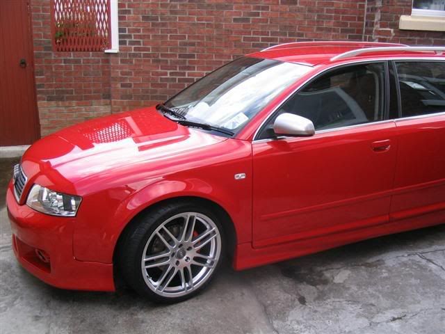

Id like to add some more wax to help keep the paintwork in good nick while the girlfriend is driving it and washing it, when im away!
i dont mind giving it 20 coats if i have to...i just dont know what is best!
ive got a new tub of collinite 476 wax paste so just want to know what prep work to do before and the best way to apply?? with or with out PC and how long to leave??
