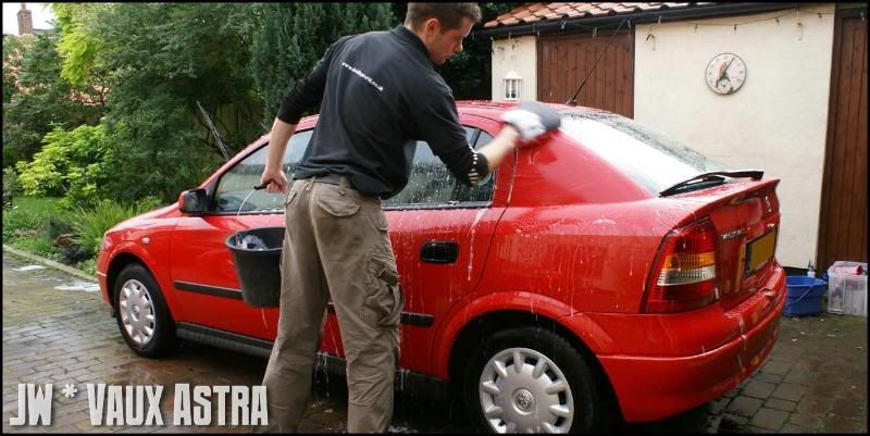

Take one faded Vauxhall Astra. Spend 8 hours on bringing the paint back to life. No defect correction, no interior/engine bay work. Take lots of pictures and then wash out the red on the pads/clothes!
Process

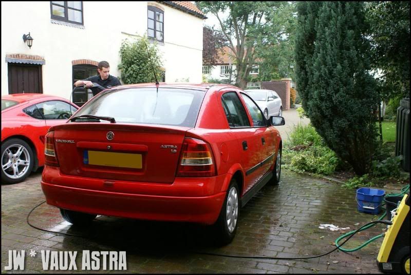

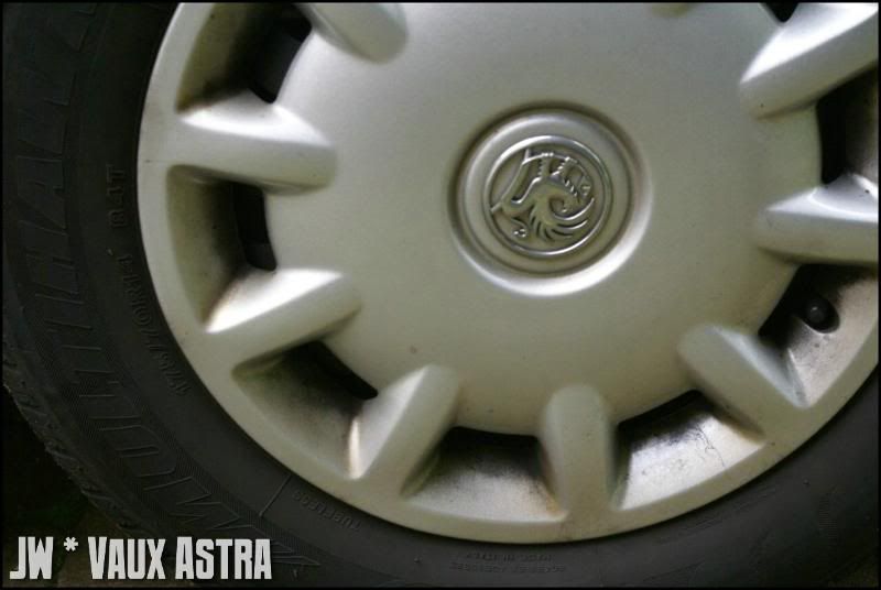

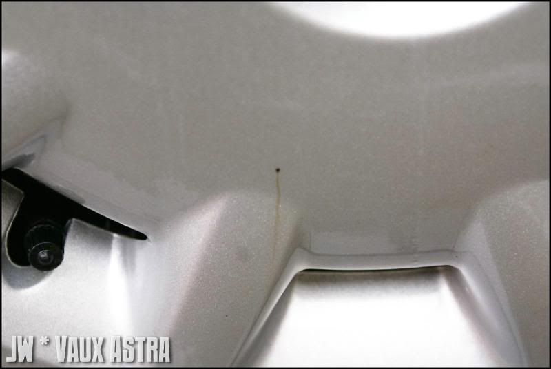

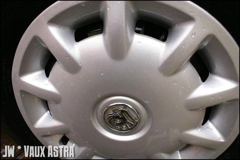

· Wheel trims cleaned with AS G101/Megs WB

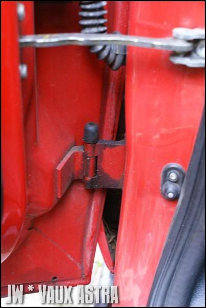

· Door shuts worked with G101 and Megs SD

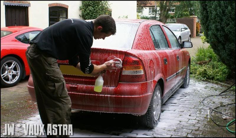

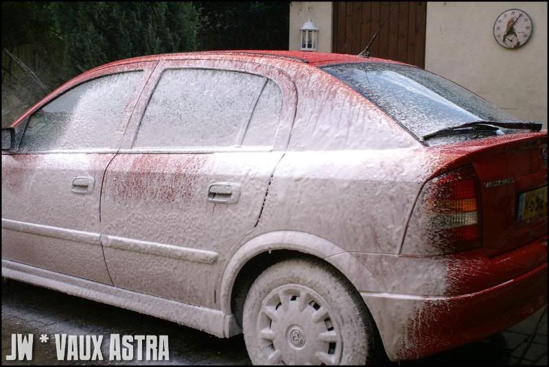

· Foamed with SuperSnow foam
· Washed with TBM and Gold Class/UltiMit
· Tar removed from lowers and wheels with Tardis

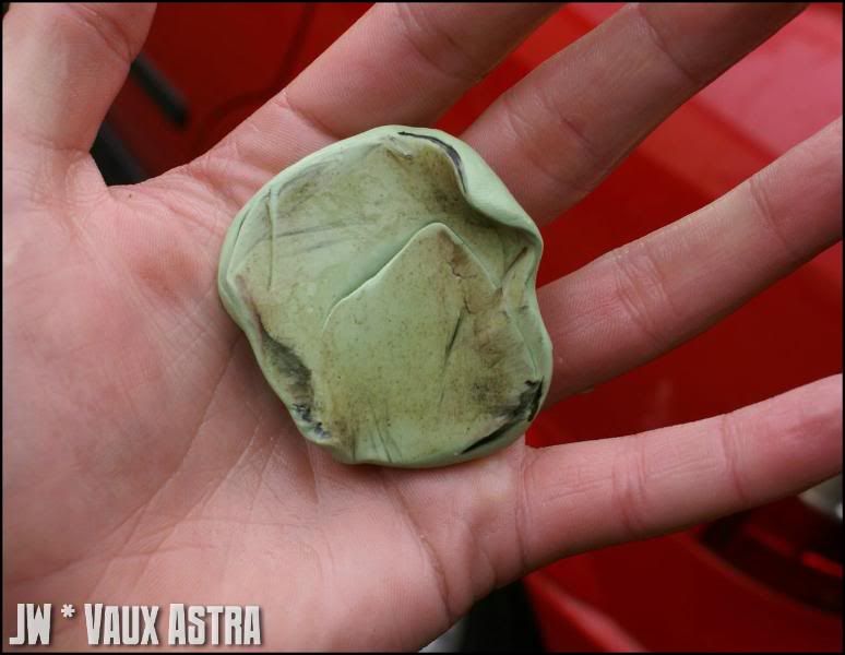

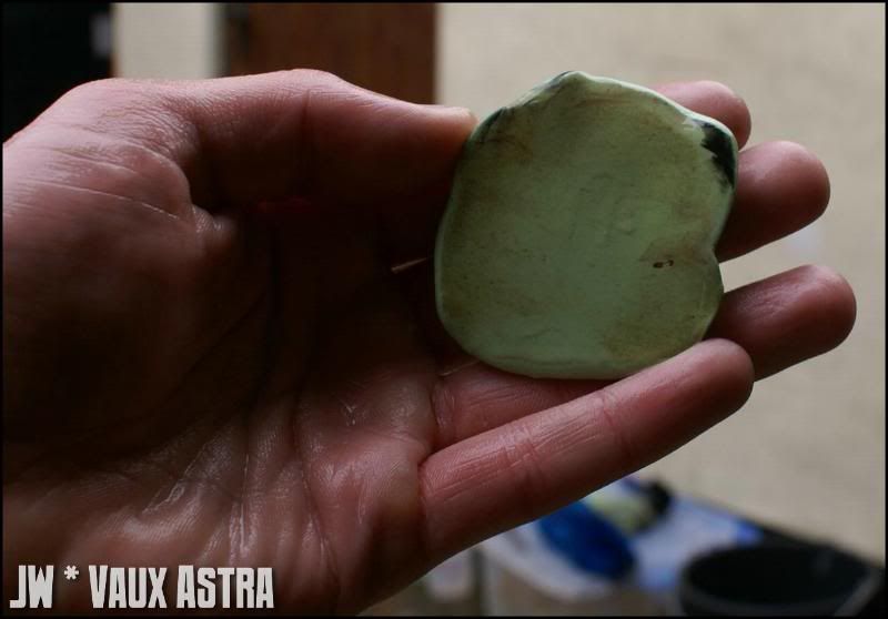

· Clayed with Sonus Green & Megs LastTouch
· Rewashed
· Sheeted water and dried with Miracle dryer

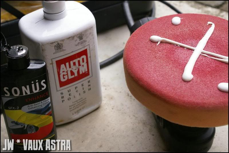

· Panels polished up with mix of Sonus SFX-2 and AG SRP on various PC pads
· Sealed with JetSEAL109
· Waxed with Collinite 476s
· Tyres/plastics/details dressed

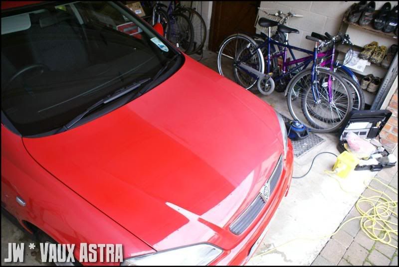

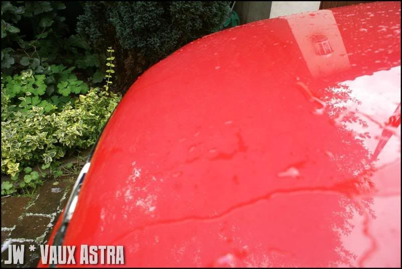

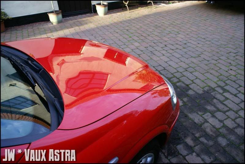

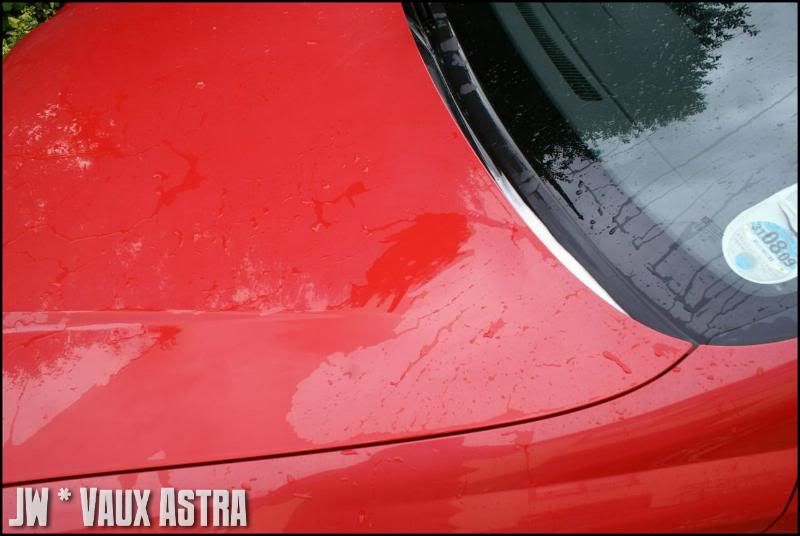

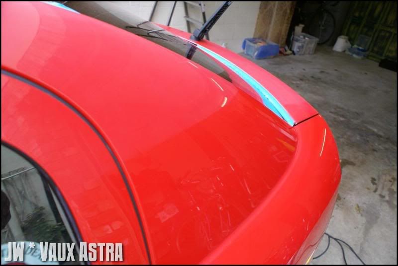

Faded bonnet..

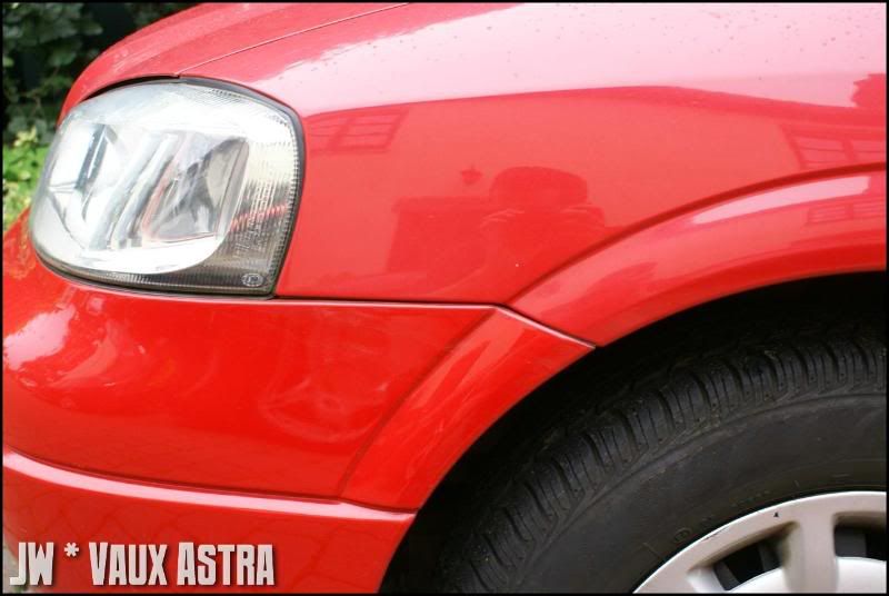

Note how the bumper hasn't faded.. Compare it to the wing. Red ^ Pink

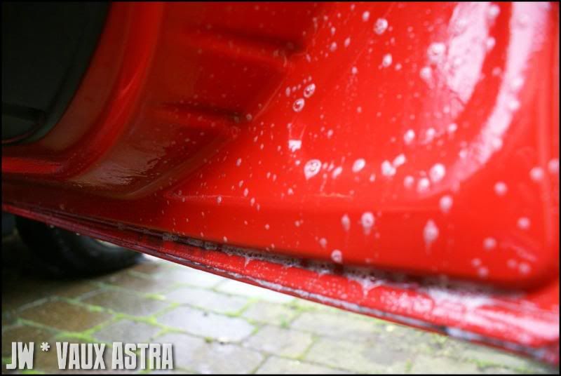

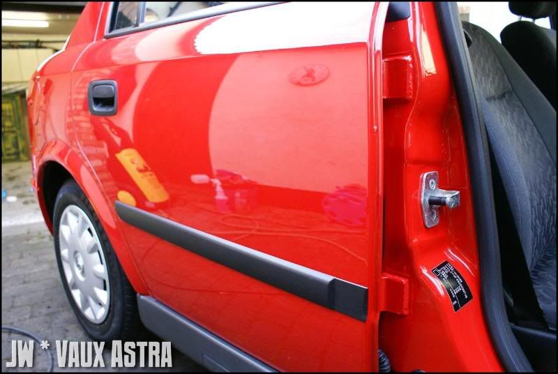

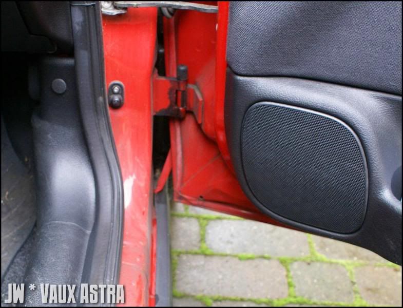

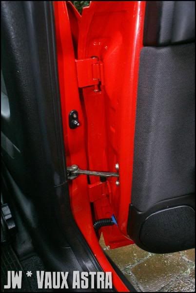

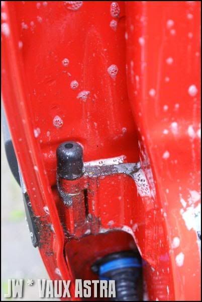

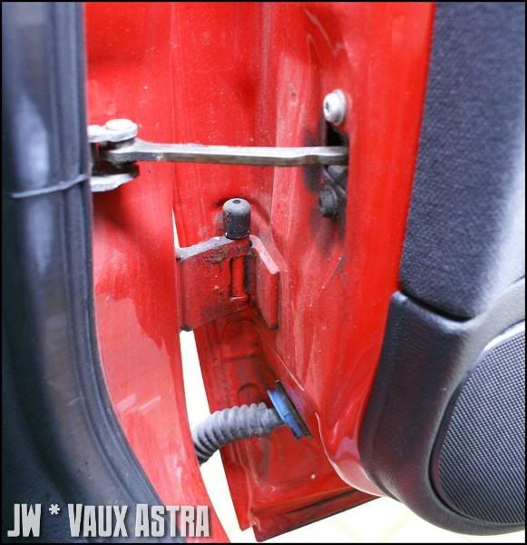

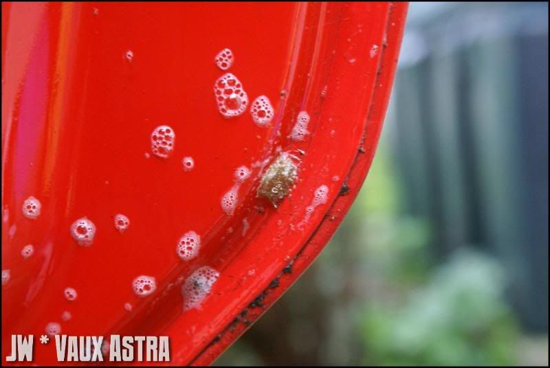

Door shuts/sills

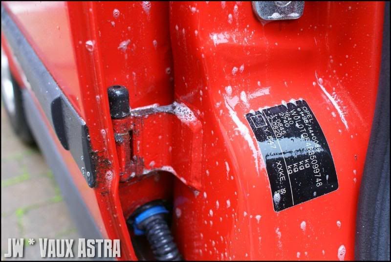

Soaked in G101/Megs SD and agitated

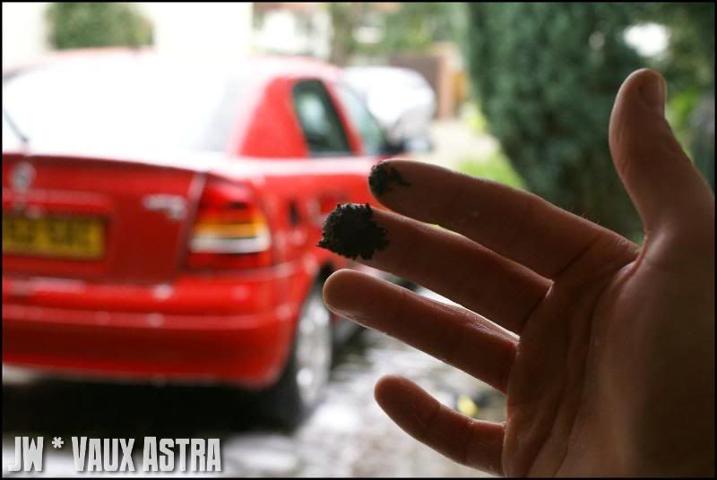

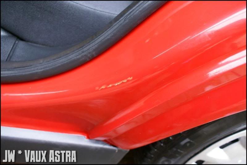

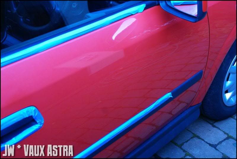

Scuff on rear passenger door removed with Tardis:

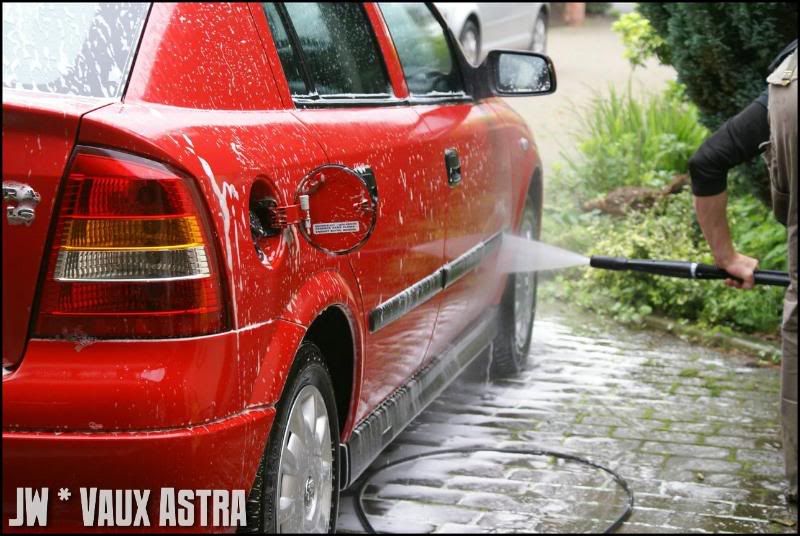

Rinsed:
Foamed:

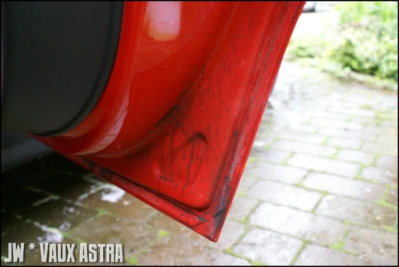

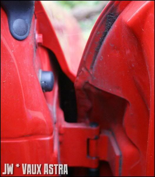

Rubbish from inner arch:
Rinsed:

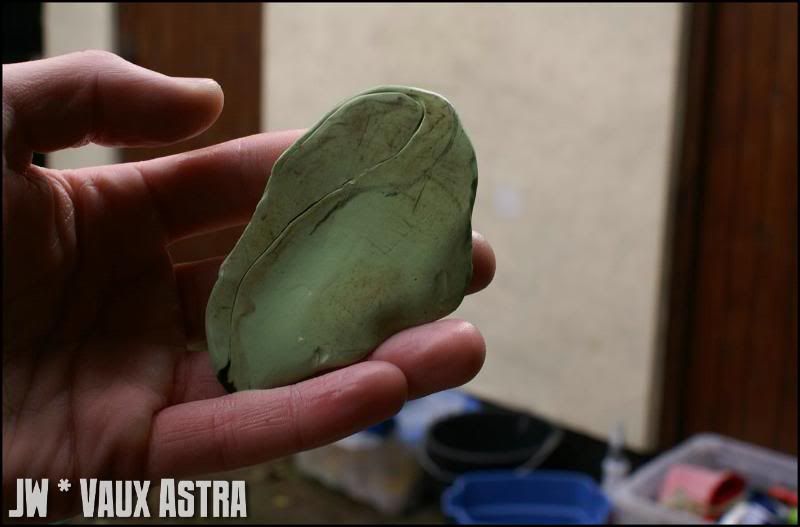

Clay various:

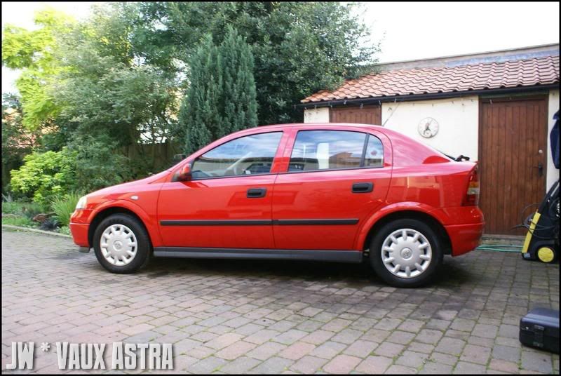

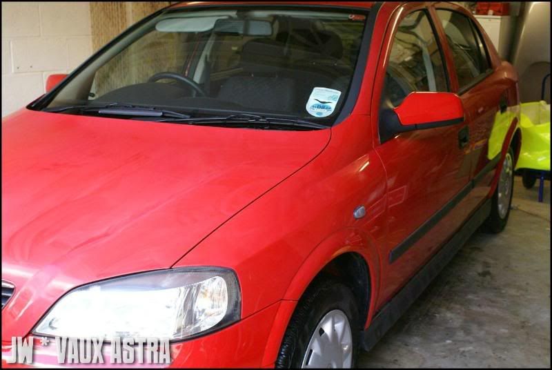

Now we have a clean car.

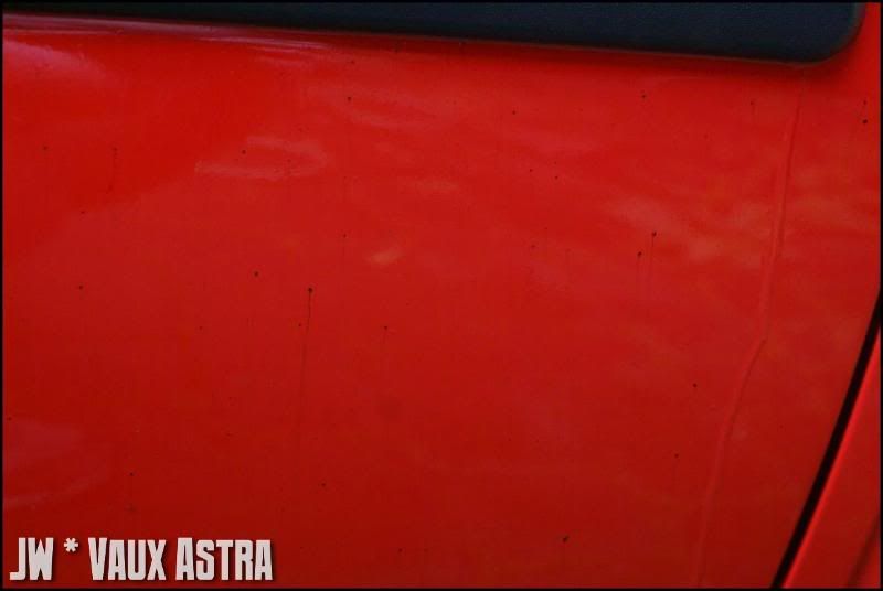

No protection:
No reflection:

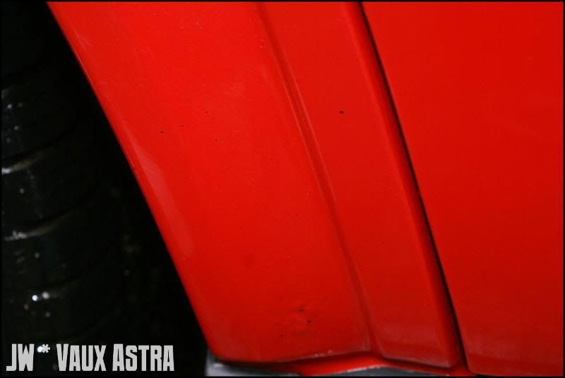

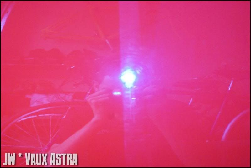

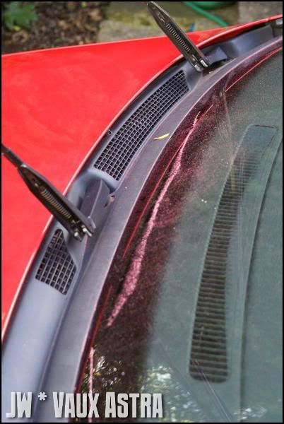

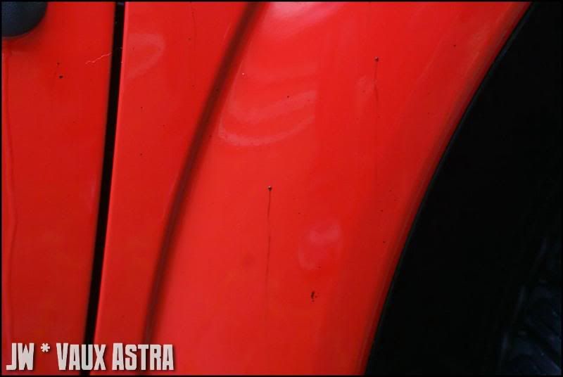

Bad oxidation:
Terrible missmatchation (my new word..):

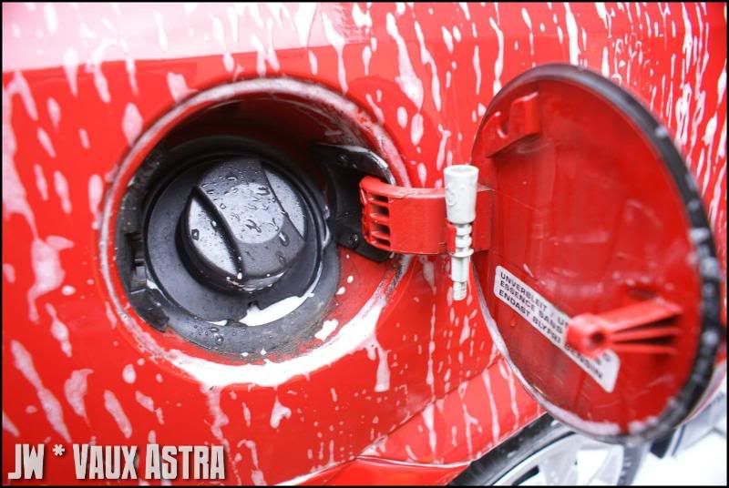

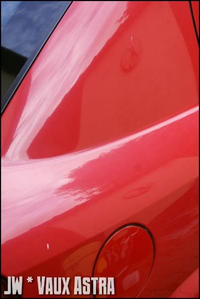

^Look at the difference in the petrol filler compared to surrounding areas

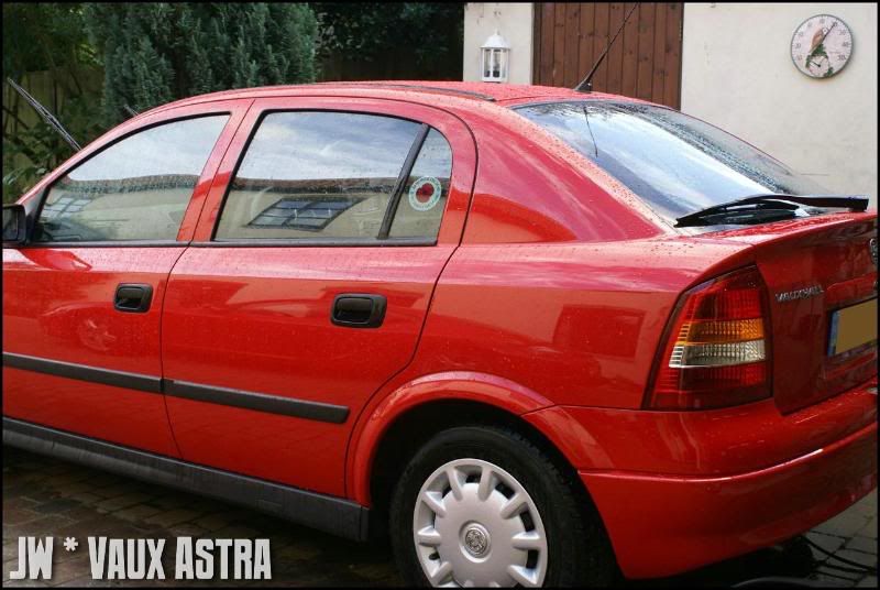

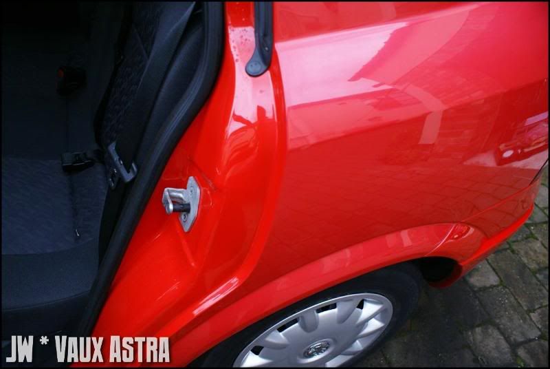

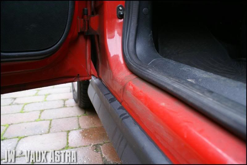

Red door sill - Pink rear quarter:

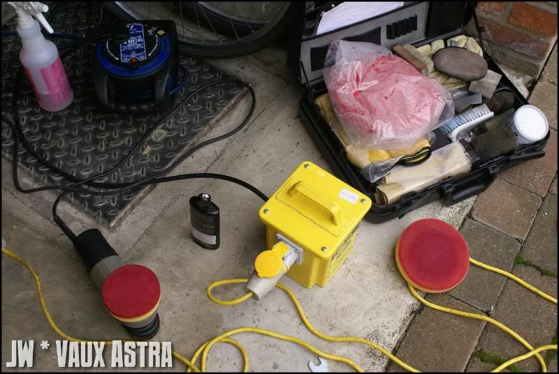

Tools aquired:

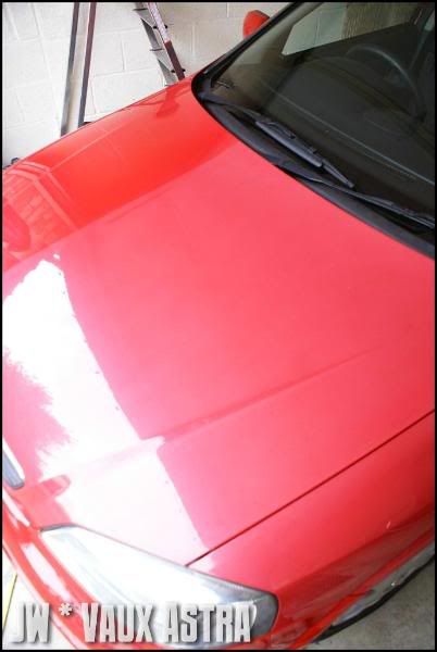

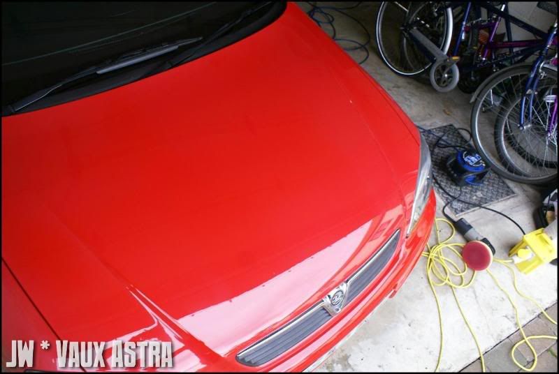

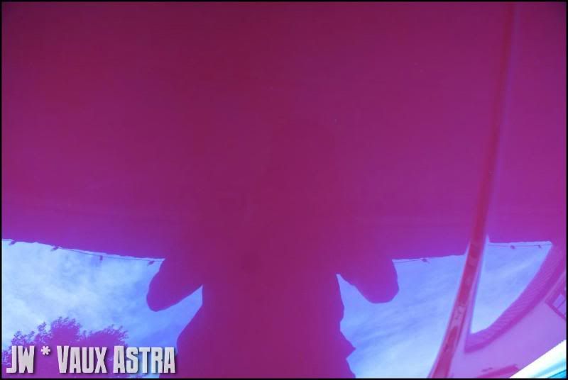

Bonnet before:
Bonnet after:

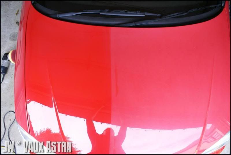

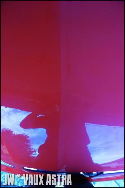

Bonnet 50/50's:
Bonnet after:

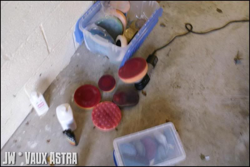

My once yellow pads…

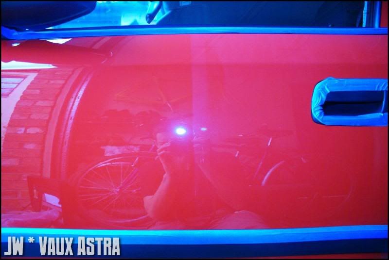

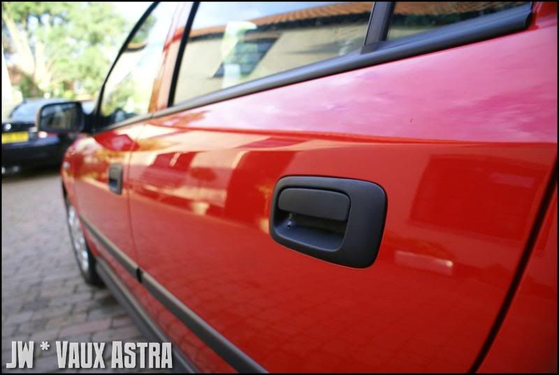

50/50 passenger door:

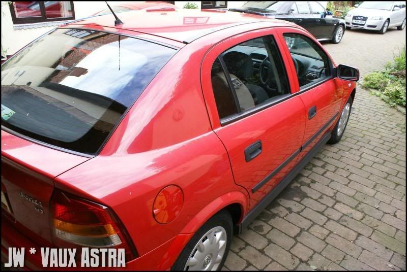

Passenger side near complete:
50/50 on upper passenger rear quarter:
Roof 50/50:
Tailgate 50/50
Passenger side DONE
Drivers side NOT done

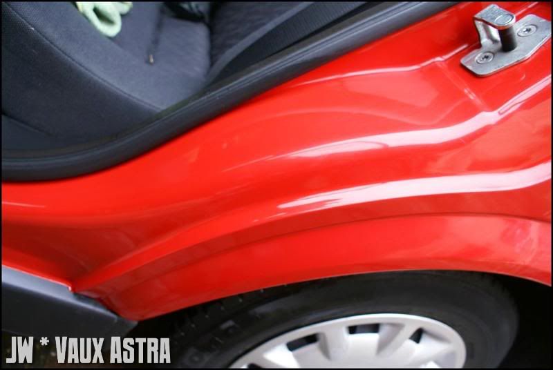

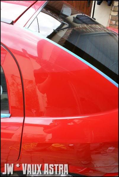

Polished rear quarter:
Non polished rear quarter:
Pink drivers door:

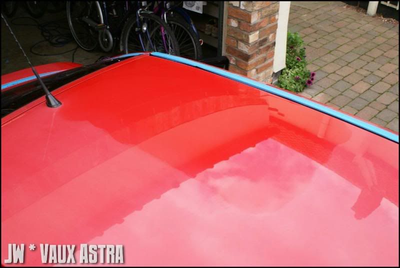

Upper rear quarter done, lower not done:

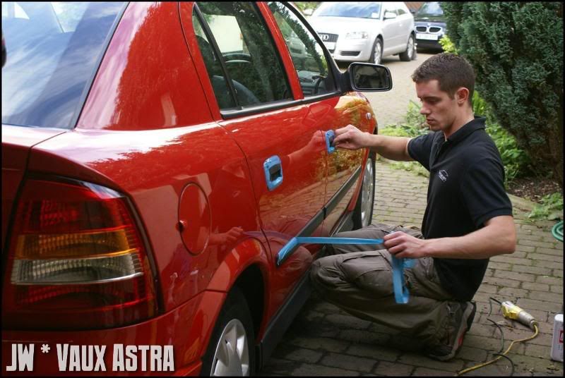

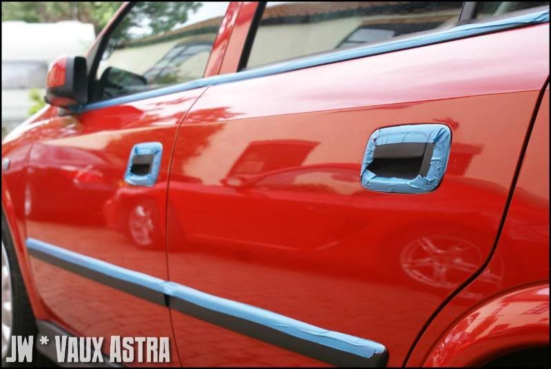

Tape removal:

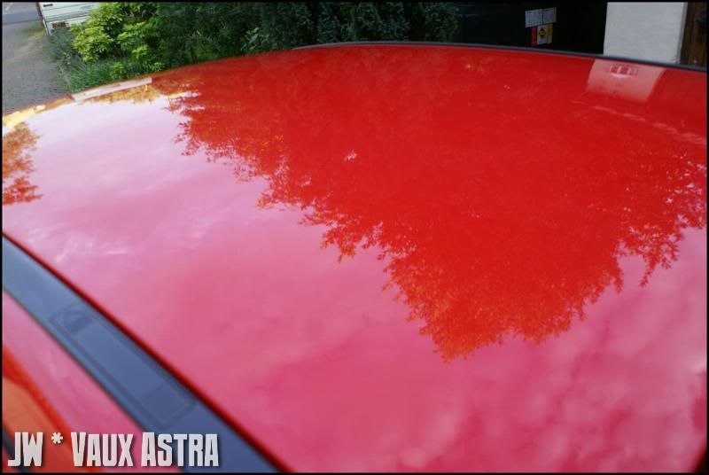

Comparing shine:

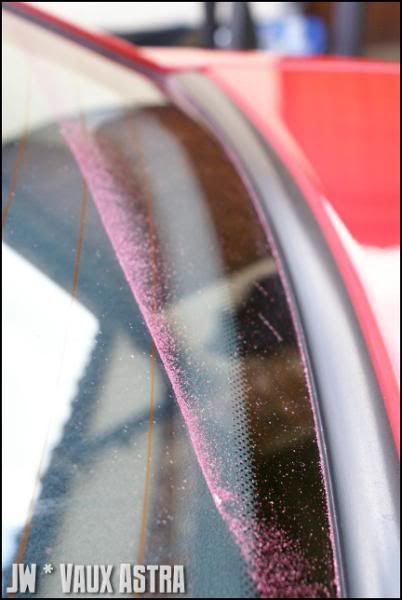

Lots of dust build up so I had to rewash the vehicle:
So it was rinsed:

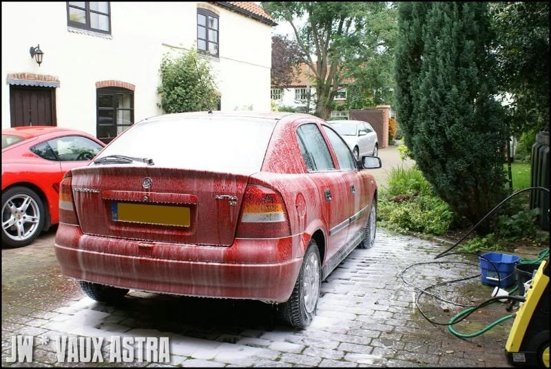

Foamed:
Then washed and dried.
Into garage for JetSeal09:
Blurry picture of the red pads:

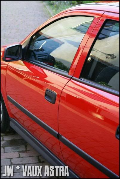

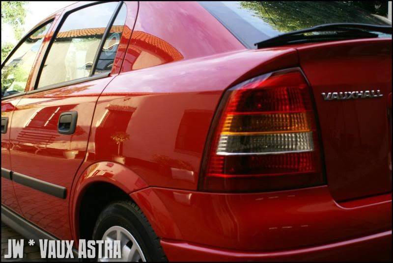

Wax applied and buffed. Trims worked. Sills waxed. Tyres dressed.

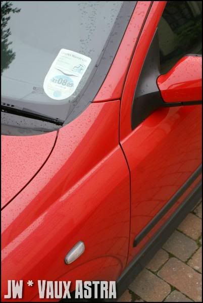

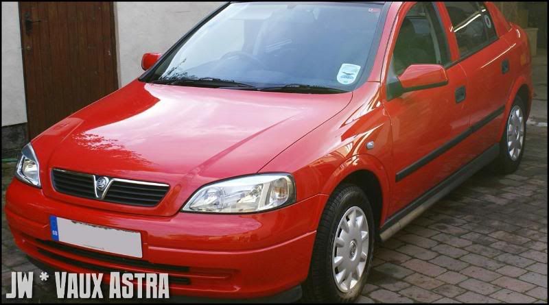

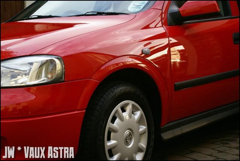

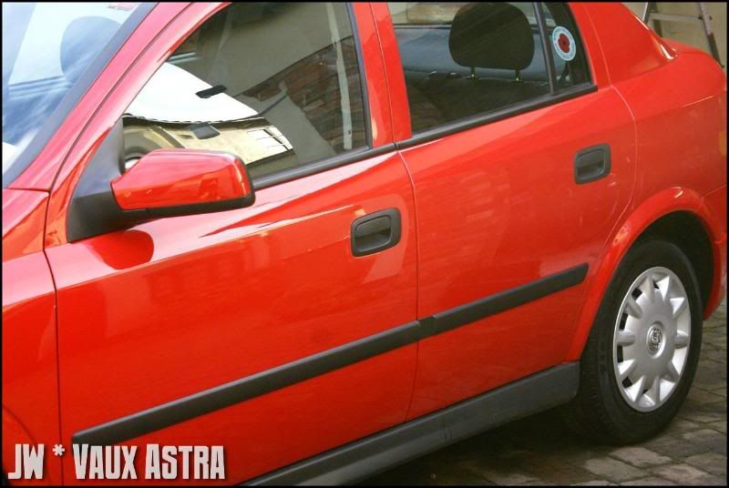

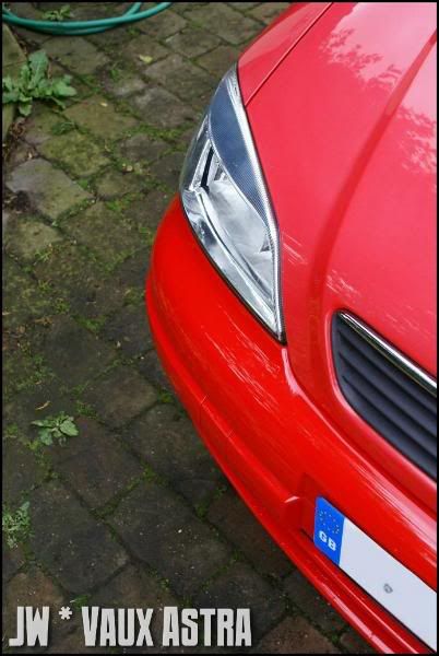

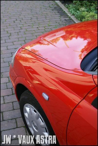

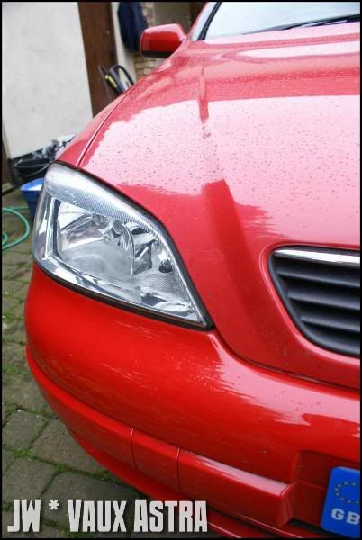

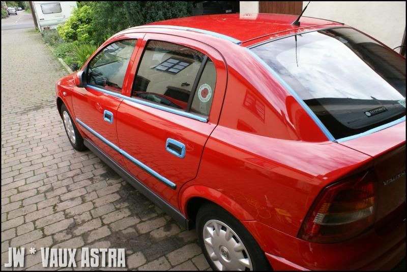

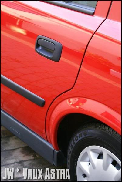

AFTER
^now needs a clean, fresh number plate#
Owner was very pleased. Couldn't believe the turn around.
Quite a satisfying job.

looks great.its strange that the bumpers and other plastics dont turn pink.anyone know why
I'd like to know this also.. probably a different laquear/clearcat/protection put on lower areas?! Meh.. saying that, the petrol filler cap had life in it still, yet the surrounding areas had faded quite badly. Something to do with plastics. :speechles:confused:
#14 ·
I'll have a go but i'm preparing to be shot down in flames.
The metal panels will expand/contract more than the plastic with heat/cold. This will stress the paint probably resulting in micro-cracks. These would diffuse the light hitting the paint and turning it white (faded).
The paint plastic would not be subject to the same conditions.
Or......
Vauxhall used a diffrent formulation in the paint to get it to stick to plastic.
Probably the latter me thinks.
#24 ·
Jim, how did you wash the pads afterwards? I am having trouble removing the paint from my pads.
After this job Elliott a few of the pads had to be 'designated red/pink pads only'. They were pretty bad..
Most of them came up OK. I fill a bowl with warm/hot water with a wash detergent in.. leave them to soak for half hour. Then with a small stiff brush, I give them a scrub so to speak, kneading and rinsing as I go. Finally, change of water, run under running tap and rinse. Leave to dry.
I've never put mine in the washing machine.. I believe some people do.. but personally, I've not tried it yet.
Thanks for comments. :thumb:
#30 ·
Also, most motor manufacturers will paint the bumpers seperatley to the main bodyshell.
The painted bumpers (along with a few thousand other, seperate components!) get fitted to the painted 'shell during main assembly.
This could mean that the bumpers had a clear coat applied after painting - thus preventing the oxidisation which we see on the main bodyshell, which is obviously painted with single-stage or two-pack paint.
Some cars can show a slight colour variation between the bumpers and body, this is down to the fact that they are painted seperately - and will therefore never be a perfect match due to many factors during application.
